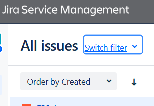

Is there a way for a default display all the issues but sub-tasks in the issue list?
When a resource logs into the Jira SM, he should be seeing only the main issues, not the sub-tasks in the listCapture.PNG

Sorry if I got it wrong but, you can add below JQL to your filter to exclude subtasks
issuetype NOT IN subTaskIssueTypes()
then if you make that filter as the default filter, that would work.

Not the default filter but you can change the order and drag the filter to the top. SImilarly you can do the same for JSM queues.

I have few custom filters. But how should I add it in the 'Switch filter'?
