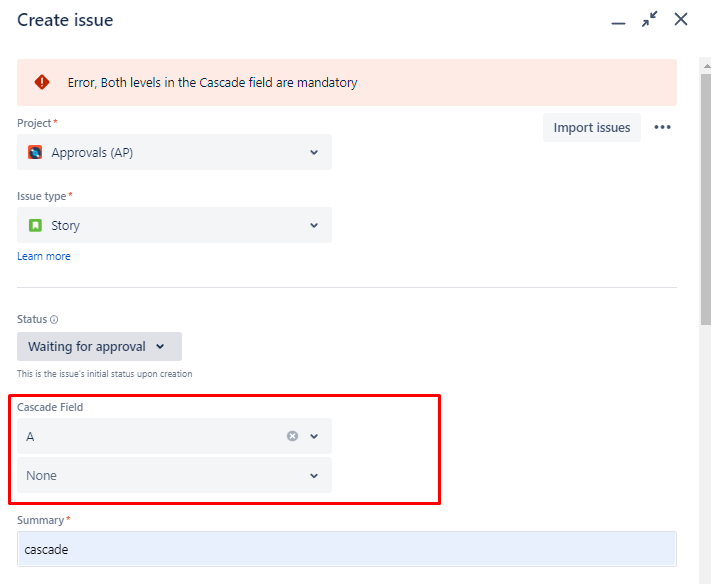

How can i force the selection of two fields in a Select List (cascading).
If you see in the second photo there are two fields but if i only select in the first field i can open the issue.

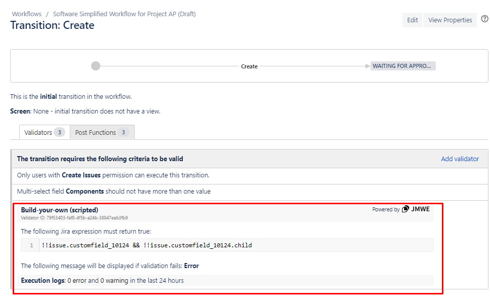

With Jira Misc Workflow Extensions (JMWE) you can create your own script validation like:
This will through an error if the Cascade child is empty

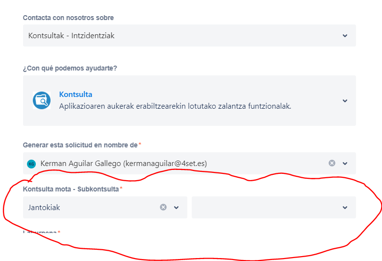

Hello everyone,
Hopping that this solution works for all of you, it did in my case.
First of all you need to have the ScriptRunner application installed.
Then, in the workflows transitions (in my case in the "create issue" transition), press on the transition and click "validations" option. Now you can create a new validation using the ScriptRunner Script option.
Use the following expression to avoid request creations without completing the child field of a cascading custom field like yours:
issue.YourCustomFieldName.child != null
You can also include the error message description you want to show.
