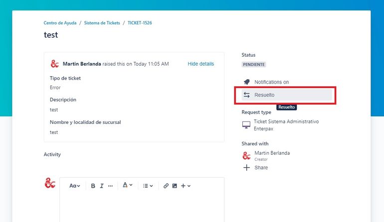

Is there a way to prevent our customers from marking a ticket to solved for themselves? I have been ask to remove the buttón with that function from the portal, but I can't find that configuration nowhere
This is the button, the status is on Spanish, but means "Solved"

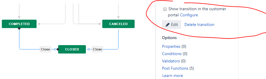

Hello @Martin Berlanda
You need to go to your workflow and in the diagram view click on the "resolved" transition and then uncheck the box shown in my image. image.pngI hope that this answer solves your issue! :-)

Martin Berlanda
March 11, 2020
Yes! This is exactly what i was looking for, Thank you so much!
