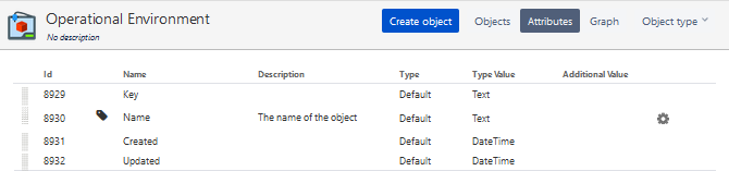

After working with support we discovered that there's a bug with External Imports when using label in a referenced object's IQL. A workaround is to switch to an attribute key for the referenced object.
In other words this attribute definition
    "attributeName": "Operational Environment",
    "attributeLocators": [
        "op_env"
    "objectMappingIQL": "label = ${op_env}",
    "externalIdPart": true
with this object type attribute config
should be changed to
        "op_env"
    "objectMappingIQL": "Name = ${op_env}",
for the same object type attribute config.
