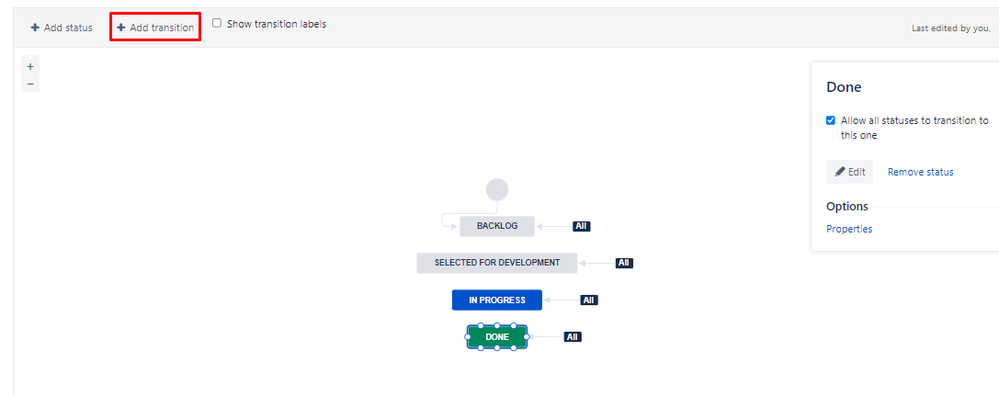

When I am on the page to edit my workflow, for all states (to do, in progress etc...) I have 4 possibilities
- Add a transition
- Delete transitions
-Edit
-View Properties
However, only for these two statuses "Resolved" and "Cancelled" I only have these 2 possibilities:
-Edit
-View Properties
I have no error displayed, just no possibility to add a transition. It is as if these two fields were not modifiable.

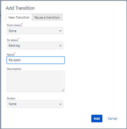

Ok thank you. I've tried but I'm afraid of making mistakes because my colleagues are working now with the principal workflow.
Do i have to :
- create a new workflow and put in on the same "workflow scheme" as the original workflow OR
- create a new workflow scheme and put in on a new "workflow scheme" ?
Thank you
Don't worry, nothing happens. You can "create a new workflow and put in on the same "workflow scheme" as the original workflow"
