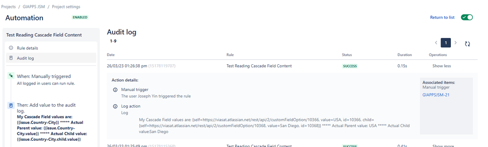

My custom field is "Country-City"
My automation rule (using log action action for debugging case on reading the field value) -
As you can see if just using {{issue.Country-City}} smart value reference - I can see the return value is -
My Cascade Field values are: {self=https://viasat.atlassian.net/rest/api/2/customFieldOption/10366, value=USA, id=10366, child={self=https://viasat.atlassian.net/rest/api/2/customFieldOption/10368, value=San Diego, id=10368}}
However, if I want to access the actual parent and child option values, then I have to use
{{issue.<your customfieldname>.value}} - To obtain the parent option value
{{issue.<your customfieldname>.child.value}} - To obtain the child option value

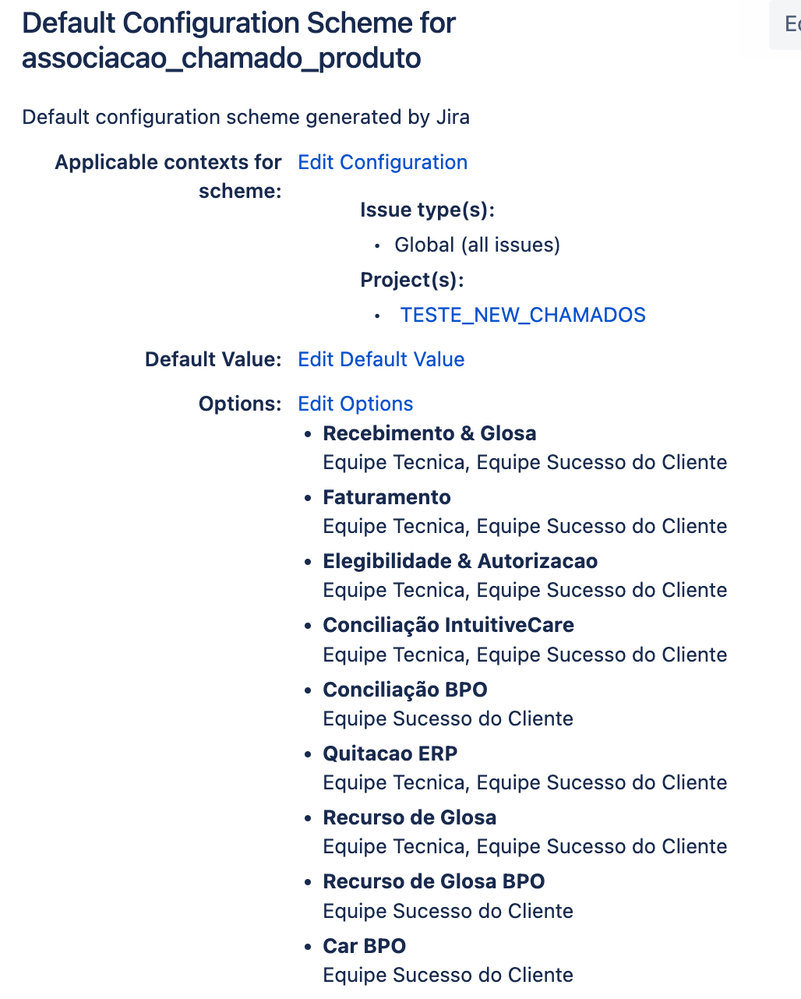

I'm not trying used it on email. I created a automation to read this value and take a action on it. The type of custom field is Select List (cascading). This custom field concats the first and second choice in a string.
Marcos Lopes March 26, 2023
I had set a configuration for this custom field:CleanShot 2023-03-26 at 12.51.59@2x.png
