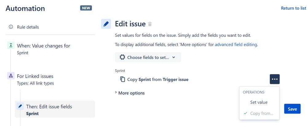

You should use a Branch in the automation rule and set this to action all of the linked issues.
Then using an Edit Issues action under this branch, selecting the Sprint field from the dropwdown, you can click on the 3 dots and select Copy from, and select the Trigger Issue as seen below.
You can then either add the email action directly under the Edit Issues action (which will send the email to reporter of all of the linked issues) or you can add the email action outside of the branch, which will only send the one email to the reporter of the triggering task.
Hope this helps, let me know if you have any questions!
Also if you need to use any smart values in the email, check out this link for all of the sprint-related smart values available - I think from what you've described, you're looking for the Sprint Name, which would be {{sprint.name}}.
