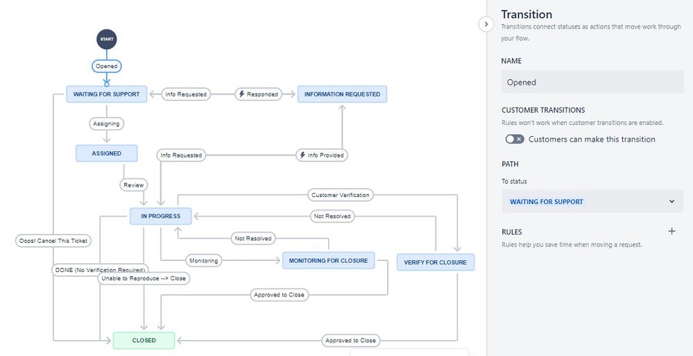

Wendy Sachen
October 18, 2023
That's what I don't understand, because there is no approval step defined in the WF.  It is during the creation of the ticket before it hits the Waiting for Support.Screenshot 2023-10-18 123030.jpg
Joseph Chung Yin
October 18, 2023
@Wendy Sachen -
Click on the "Waiting for Support" status.
Best, Joseph

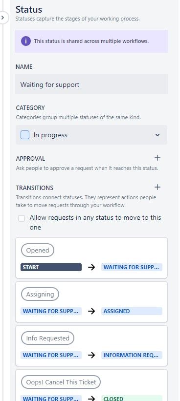

Wendy Sachen
October 19, 2023
Joseph Chung Yin
October 19, 2023
@Wendy Sachen -
Are you sure you are accessing the right WF and the Request Type?
It is because that is typically how approval process is setup out of the box.
Best, Joseph
