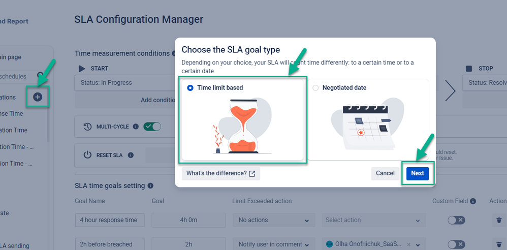

To do what you described in your question, you just need to create a new SLA Configuration, choosing the "Time limit based" SLA Goal type.tlb.png

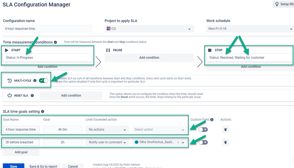

Then select the Start and Stop Conditions (like in the screenshot), multi-cycle option, and time goals:response time.png
Hope that's what you need.
