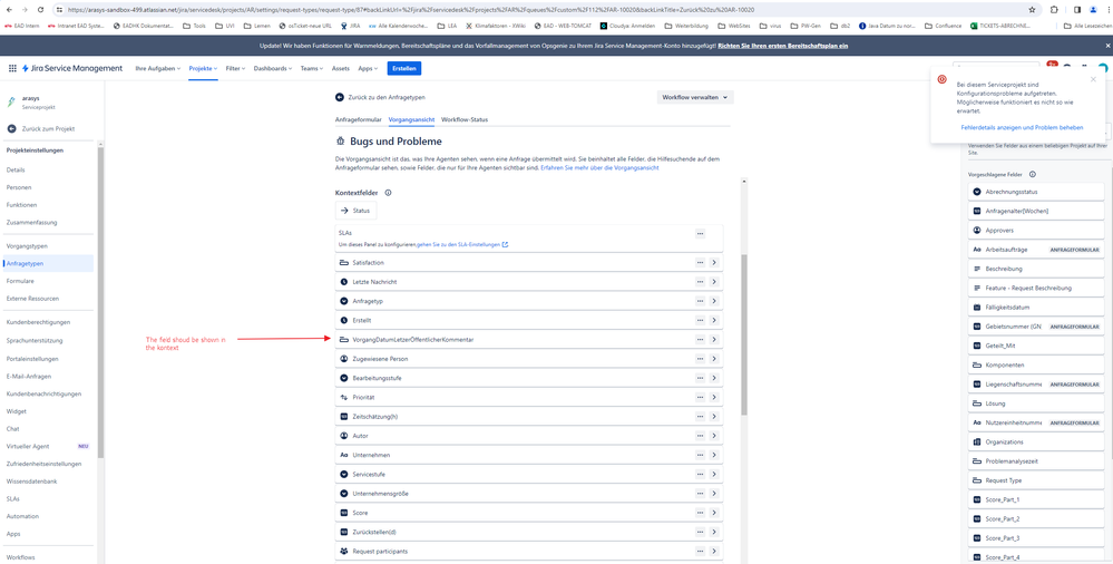

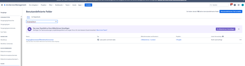

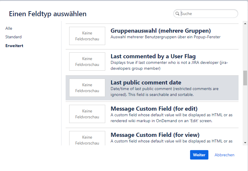

I got a custom field based on the fieldtype "Last public comment date" and want to show it with the value in the process / issue view.
The field is configured like the other fields shown there.

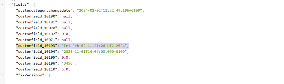

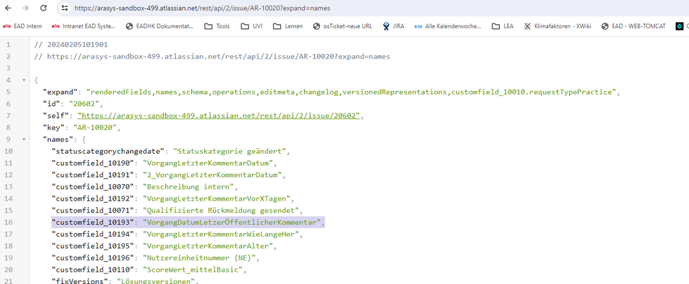

From the json view of the issue i can see that the field is there and that a value for that is there.

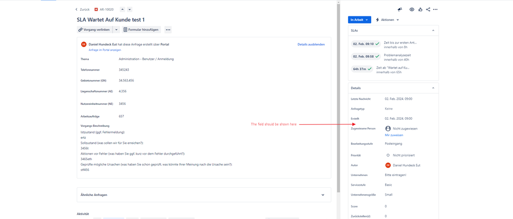

But it will not be shown in my process / issue view.
Does somebody now what I have to do?
At the moment I show this info with another field an with a rule that is executed when a comment was set on the issue. But we have to save rule executions and I would now like to show the Info with the "Last public comment date" - fieldtype, because there the Info is just there without to have a rule execution.
Please see screenshots!

I am in contact with Atlassian - Support. They said it is a bug.
They will fix it in:
 JRACLOUD-82982

Hi @dahu
Have you checked the bottom right of the Issue View? Dates like "Created" and "Updated" are now shown there and cannot be moved into Context fields. Maybe that's the case for that Field Type as well?

No, the field is not shown on the right bottom of the issue view. The field like you said, "Created" and "Updated" are there.
But i can not see a possibility to put the field there. And in the end, i really would like more to see it with the other context - fields.
