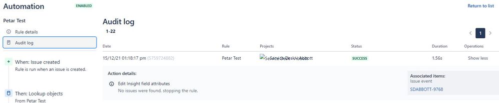

When an issue is created I would like to update some Insight object's attributes. I tried a few solutions but every time I got a "No issues were found, stopping the rule" message.

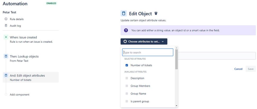

Hi @Dirk Ronsmans ,
I tried use the automation:
It seems that issue triggers don't work with Edit Object action.
Do you have any other ideas?

Could you remove the double quotes " " arround "Name"? I know Insight is really picky about syntax and for me that gives an invalid syntax.
Have you tried clicking the "validate syntax" button?
The rule is triggering but the result of the lookupObjects seems to return nothing. Hence we have to make sure that the IQL is correct.
You can also copy it in to the Advanced search bar in Insight for that objecttype to validate the outcome.
