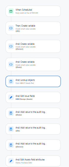

Following the log action these return the exepected number, name and date that I would like. I have now found myself another problem and wanted to ask to see if you could provide guidance, here I want to create a SMART variable from these which I have done with the create variable, this works fine as if I test with the log action it is correct. What I have struggled with is to then use the SMART variable in an aql search with lookup objects. The ID essentially is a component of the "Name" attirbute I have in assets as well as its own "Ledger Number" attribute which expects an integer. I have tested the lookup objects with manually entering what I expect the output of the SMART variable to be ""Name" LIKE "TEST Stamp - 1005" which works but If I replace the "1005" with {{ID}} - my previous SMART variable - it no longer works and no objects can be found. Could you perhaps point me to some documentation or help me understand the interaction here with the AQL search that prevents me from getting my expected result?
Here is the automation flow I am using-
Alex Koxaras _Relational_
July 24, 2024
Hi @Roland Kiss ! I thought that you needed the ID, Owner and Date :) That's why I included them within the regex. I'm glad you found out how to get the values however :)
When creating a smart variable, all the items within the array are considered to be text. Try to use the .asNumber smart function to use the number instead: https://support.atlassian.com/cloud-automation/docs/jira-smart-values-text-fields/#asNumber
