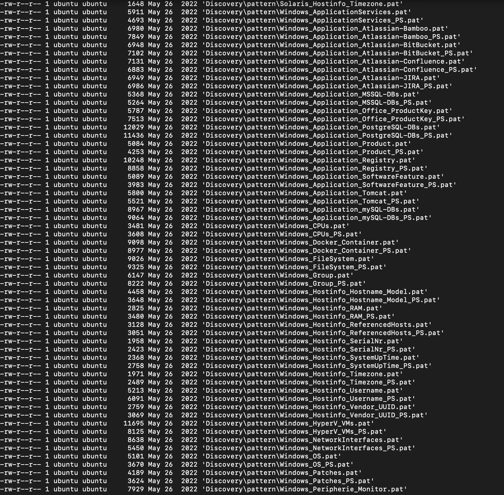

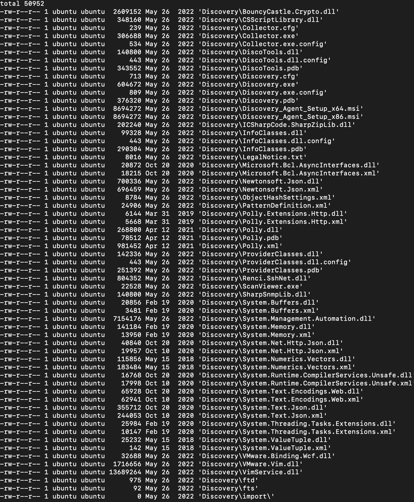

What are the permissions for Discovery.exe?  Can you run "ls -l" on the directory and show the output?
Cami
November 28, 2022
Screen Shot 2022-11-28 at 10.06.41 AM.pngScreen Shot 2022-11-28 at 10.07.21 AM.png
I have also tried mono <full directory path>/Discovery.exe -s
