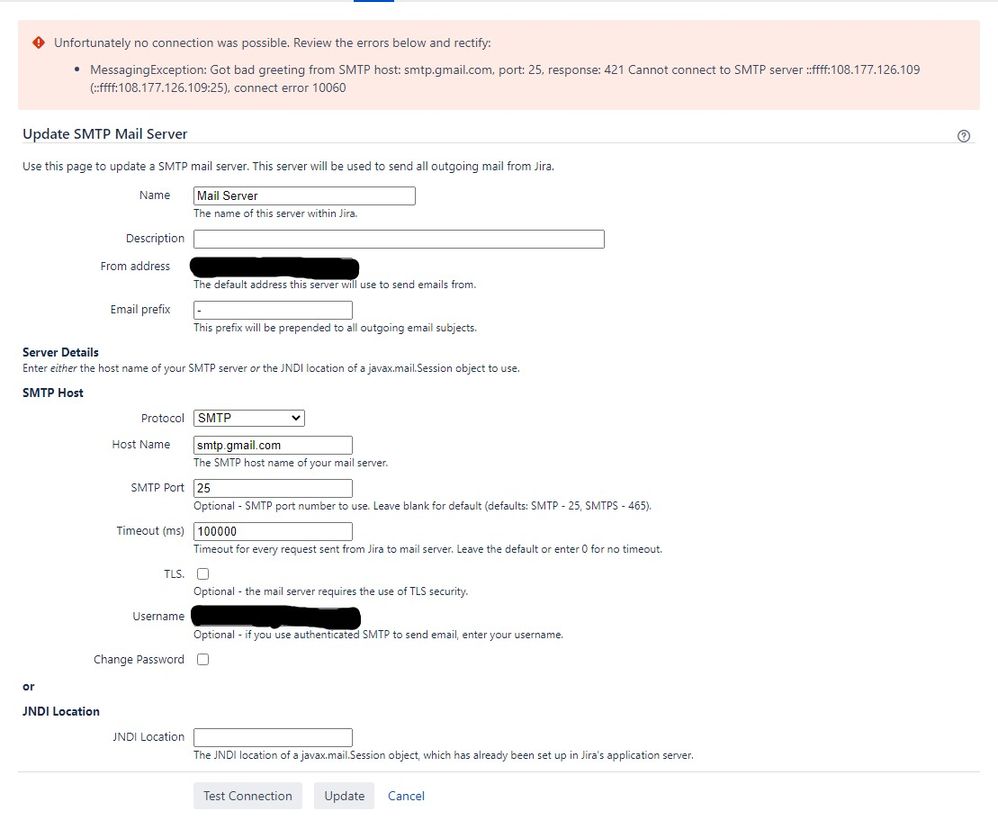

This is probably a network/ firewall issue. I don't think the port for gmail smtp is 25.
I found Gmail's SMTP settings on https://support.google.com/mail/answer/7126229?hl=en
Try enabling the TLS checkbox and use port 587
You'll also have to make sure your firewall allows connections to that port

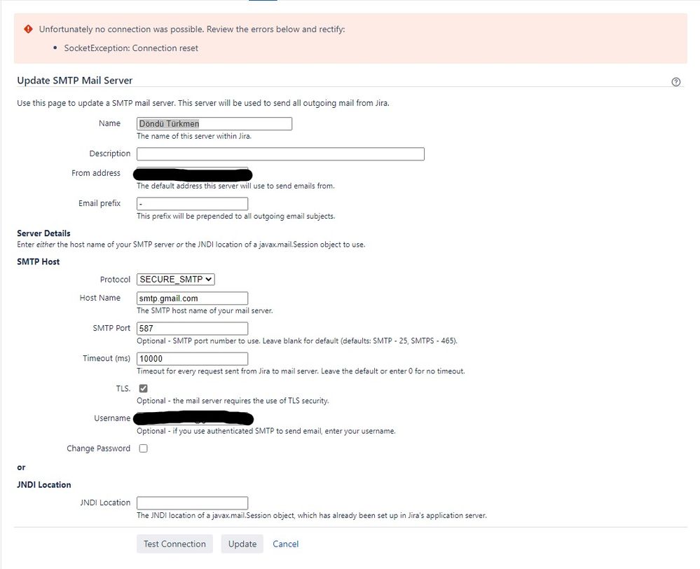

Thank you for your answer. However, when I do this, I get an error like this.
Have you tried selecting the secure smtp option in the protocol field?
You can also try port 465. Try the multiple combinations of Protocol and 587/465 port. I don't have a Jira server where I can test this at the moment.
I think you also need an https://support.google.com/accounts/answer/185833?hl=en in gmail but the error you are getting is certainly not related to that
When I type 587, I get this error. I keep getting the same error when I type 465.

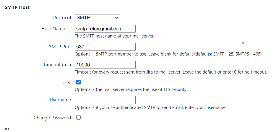

You could also try this: smtp-relay.gmail.com but I think it only works for companies with Google Workspaces.
Thank you very much for your help. I keep getting the same error.

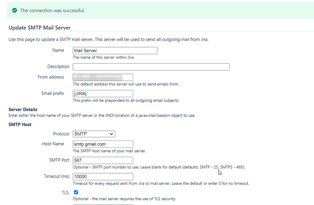

I think you need to check your firewall because this works for me:
