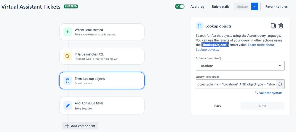

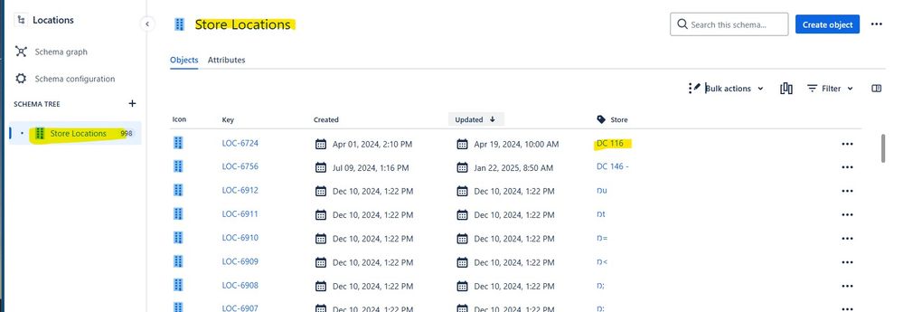

I have a dropdown menu tied to an asset field called Store.  I need to create an automation that will set the asset value in the Store Location field to 0000 once a ticket is created. I created a Lookup Object in Automation that has the following AQL :
objectType = "Store Location" AND "Store" = "0000"
I then added an Edit Issue Value and put the {{lookupObjects}} in the Store Location field.
When I open the ticket, it is not selected.

If you are in your asset schema and use the AQL, what is the result of your query?
AQL should in my experience be: objecttype = "Store Locations and Store = "0000"
What is stated in your edit action and what is the configuration of your custom field?
