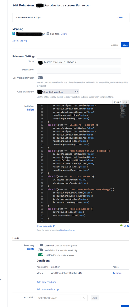

Here is the configuration screenshot. Sam is configured for other issues types and it is working fine. I will follow the steps suggested by you. Thanks
Ah, actually I see, it probably has a problem reading the Summary because you're hiding it.
So maybe it will help to remove that Summary->Hidden part, and instead hide it from the script itself after you read the value.
Maybe the Summary part is executed first and then your script is executed after it, which might be something to try.
I just unhide the Summary but the issue is, Fields are not getting visible on Issue Transition Screen. For both type of issues eg. Summary== XYZ or Summary != XYZ.
