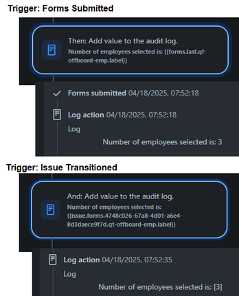

I do have one automation that uses the "forms.last" method to get the data from the form upon initial submission. This automation will update the initial ticket and create a table in the description based on the number of employees selected. I added a logging step to the initial automation and noted it returns a non-bracketed value, like your example.
The second automation (the one I'm having issues with and as you noted is return bracketed numbers) creates subtasks for different teams for each employee (3 per employee). The second automation kicks off after the initial ticket has been fully updated. I use the "issue.forms.UUID" call to get the data since the trigger is "issue transitioned" not "forms submitted".
Despite the calls being different, I would've expected the results to be the same given they're accessing the same data.
I'll test with having both automations kick off using the same trigger and see if that resolves the issue or just makes a mess. I will also submit a support ticket to see if they can look into why these two calls are getting different results.

Yes, I would also expect the results to be the same (when the same form instance is selected, regardless of trigger).  Let's try figuring out what is in that field...
In your current rule, and near where you are logging that value which is bracketed, add two more writes to the log:
field size assuming a list value: {{....your form field info.label.size}}
field value assuming text: {{....your form field info.label.substringBetween("[", "]")}}
If the first one returns a number (e.g., 1) then the value is a list, and could use this to get the number 3, or whatever was selected:
{{....your form field info.label.first}}
If not, the second one should correctly extract the value from within the brackets.

I've added those two extra writes and it is returning a number:
With that in mind, I'll work on making some adjustments to the automation based on either this or triggering it with the "Forms submitted." I appreciate all of your help with this issue!
- Erica
Like Bill Sheboy likes this
Bill Sheboy
April 18, 2025
Yup, it is a list of values.  Please try adding the .first to get the value.
