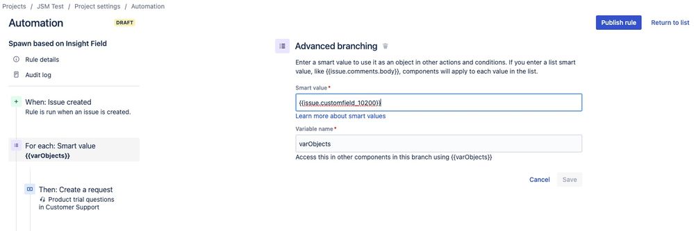

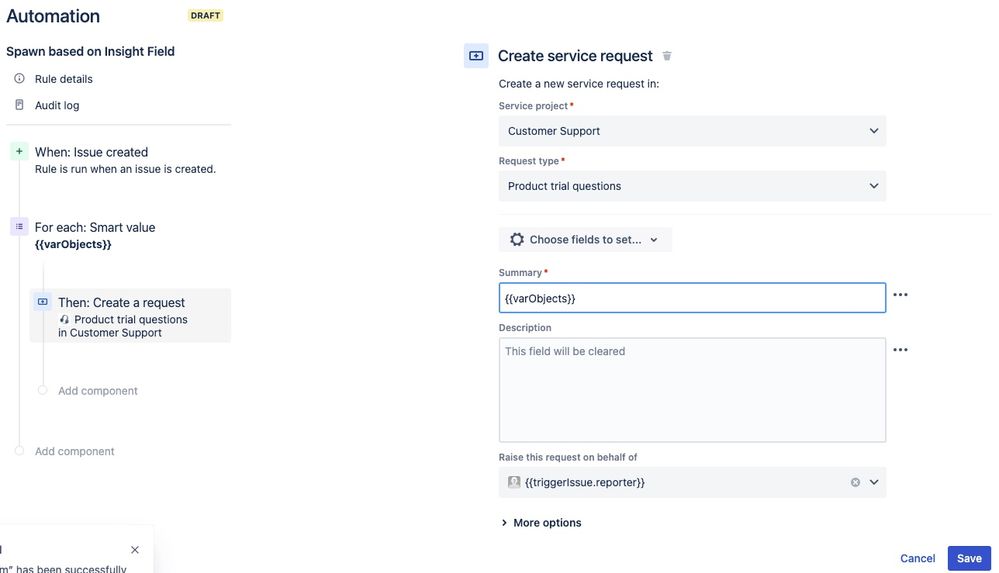

Yes... You can use an advanced branch like this:
Ste404
August 10, 2022
@Mark Segall AMAZING..   such a simple way to do it considering I had lookup objects, then a check for >0 then the smart value branch and it was all just getting confused..  very elegant in two steps.

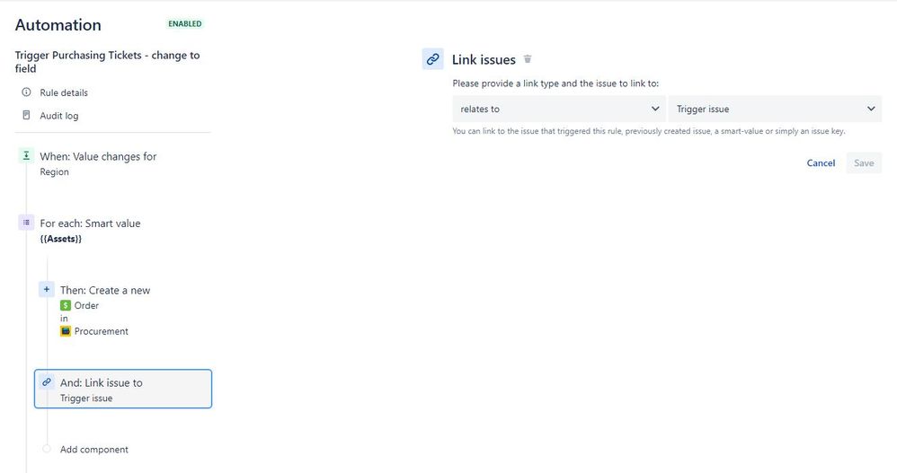

oh and also, seeing this is being triggered via automation in an issue I thought to put a 'Link Issue' in the step that is creating the new issue.  That isn't happening?
I have the simple step that after the create that is
Link Issues
Relates to - Trigger issue.  Trigger issue being the main issue that is kicking off the automation.
Not firing?

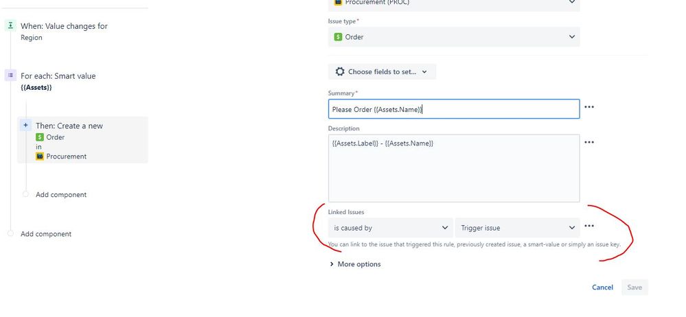

The reason this isn't working is because you're currently branched on a field variable and there's no issue anchor so when trying to create a link, it's attempting to link to itself.  However, you should be able to create the link in the same create issue action.  Just add the Linked Issues field to the create and then it should do the trick.

here is what I have, just isn't creating the linked issues.

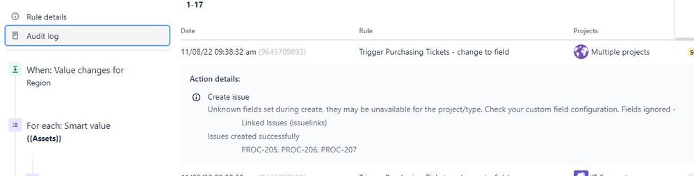

I tried your suggestion and it errors out.   I tried relates to also.
Ste404
August 10, 2022
@Mark Segall   to round off my problem, I can manually go into the main issue and create links to the new issues created in the Procurement project - so permissions and such seem all good... not sure what the issue is that is being spat out in the audit.

When creating an issue, automation is leveraging whatever you have on the create screen.  So, you'll need to make sure the Linked Issues field is available on the target issue type screen scheme.
NOTE - You may want to add a new screen tab and simply hide it there so it doesn't create noise for those who may create issues against that issue type manually.
Ste404
August 11, 2022
Ah that wasn't at all apparent as in my testing I could manually create links from the trigger issue to the Proc issues, adding the 'Linked Issues' field made all the difference.
