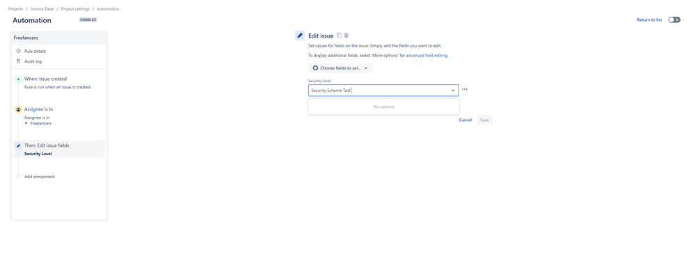

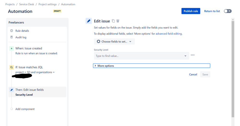

Mustafa Aydemir June 15, 2023
Hi @Mark Segall
I have tried what you have told me but when I am trying to make the automation I can't choose "my desired Security level".

Mark Segall
June 16, 2023
Did you follow all of the instructions in the link I provided in my last message?  You need to configure issue level security and then the security levels you configure will be available to the rule.  Also make sure the rule actor has the "Set Issue Level Security" permission in the permission scheme.

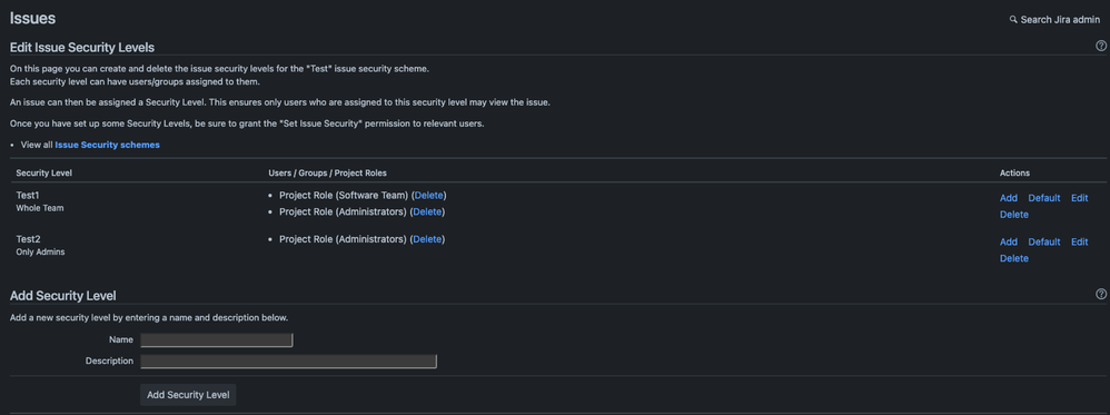

Mustafa Aydemir June 22, 2023
Hi @Mark Segall
I followed the instructions in the link you send earlier.

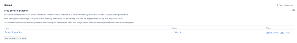

I have done all this. Check screenshot. I cannot enter the "scheme" I made in Issue Security.Skærmbillede 2023-06-22 130334.pngSkærmbillede 2023-06-22 130132.pngSkærmbillede 2023-06-22 130113.pngSkærmbillede 2023-06-22 130205.pngSkærmbillede 2023-06-22 130045.png

Mark Segall
June 22, 2023

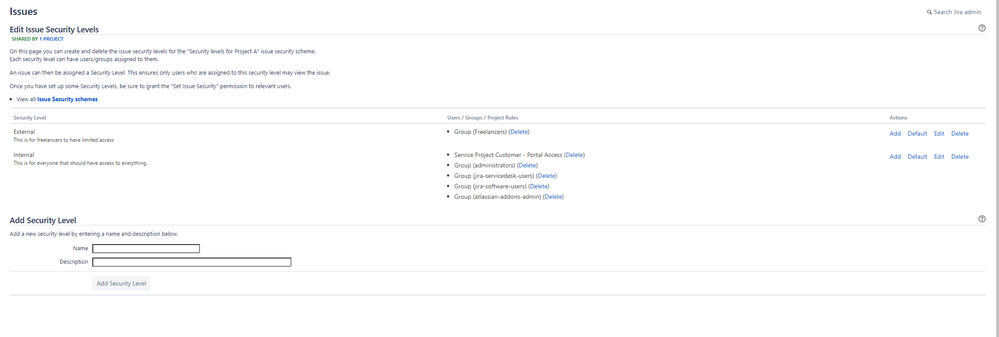

In your issue security scheme, you need to set up security levels.  The automation rule would need the appropriate security level.  Here are some sample security levels that I configured in my test environment:

Mark Segall
July 11, 2023
@Mustafa Aydemir
Thank you for the response... On question #5, are you saying that your test is working as expected?
If yes, it appears that you have issue level security configured properly and it may just be a matter of getting your automation rule working.  On the automation rule under Rule Details, you'll want to make sure the automation Actor is an account that has the Set Issue Security permission.  So, if you're using the Automation for Jira account, you may want to add add it to your project as an administrator.

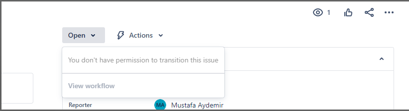

Mustafa Aydemir July 11, 2023
Hi @Mark Segall
It's not working properly.
I can create issues with the test account I have.  But when I create an issue from my admin account and I log into my test account I can't change assignee or status.

Mark Segall
July 11, 2023

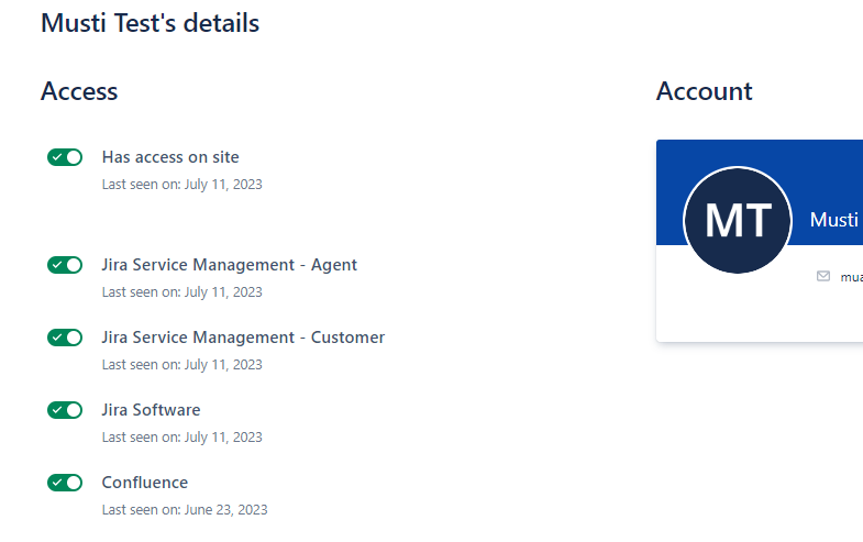

Make sure your test account has been set to the appropriate roles/groups (including Jira Service Management Users for licensing).  This is the likely cause of your test account not having the ability to assign issues.
Hi @Mark Segall
The test account has all roles/groups enabled as you see here.

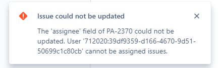

This is the error I get.

Mark Segall
July 12, 2023
I believe that you also need to assign the test account to jira-servicemanagement-users-YOURINSTANCE. This provides licensing to the test account.  This group trumps any permissions you may be granting the user.

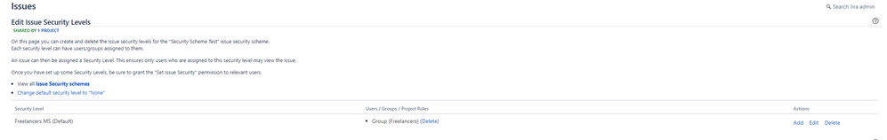

  2. If Yes to the previous step, have you configured the issue security scheme and associated security levels?  If so, please share a screenshot
    - Yes. Here is the issue security scheme.

  4. If yes to the previous step, try creating a test issue and setting security level.  Are the configured security levels created in step 2 available for selection?
    - When i try to create a issue I can only choose "internal security levels" on my admin account. I know that if I add admin on external security levels it's possible to choose between external + internalSkærmbillede 2023-07-11 121543.png

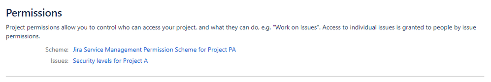

    - I have given permission to freelancers to be assignable user + transition issues. but it is not possible to do that.
    Skærmbillede 2023-07-11 122034.pngSkærmbillede 2023-07-11 122108.pngSkærmbillede 2023-07-11 122204.png
