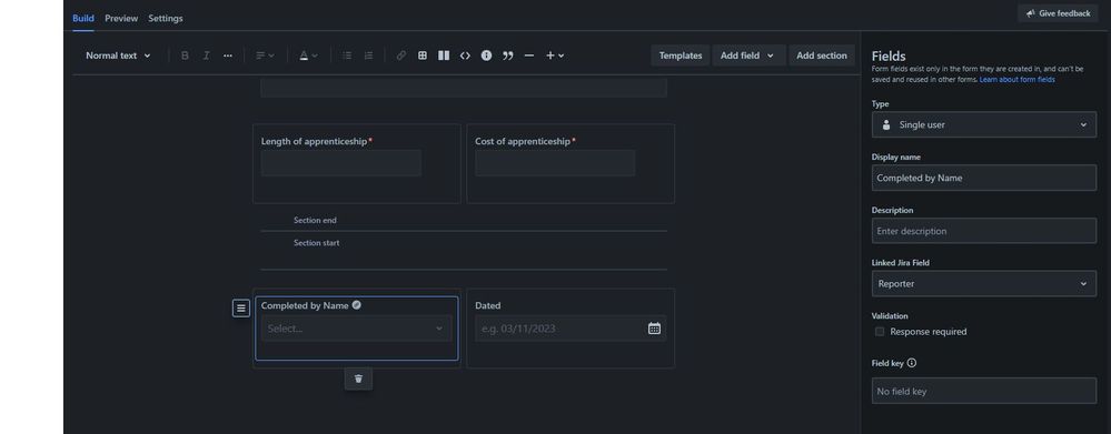

I have a scenario where I want to be able to print out a Dynamic Form as a PDF, and at the end of the form show the person who submitted it and the date it was submitted. This is necessary as we need to prove who made the request and when. Yes, I can see this info in the Jira issue, but if we need to print and send this out to anyone that info is lost. Any type of approval form or contract would require this.
To do this, I thought as the Reporter field in Jira should hold the correct value for the person filling in the form, I could introduce this at the very end of the form, along with a date field.
However, the reporter field does not populate automatically. Naturally, the Customer can set this field, but it would be nicer to have this set automatically when the Customer is filling in the form via the portal.
Is there any way to do this as I can't see that it's possible?
It would also be nice if I could lock the field down if it could be automatically filled in so that the Customer could not change it.
Am I missing something very easy as both don't look to be possible, but I thought I'd ask!

Screenshot for reference:

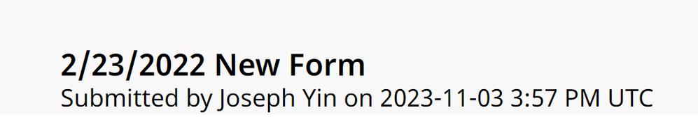

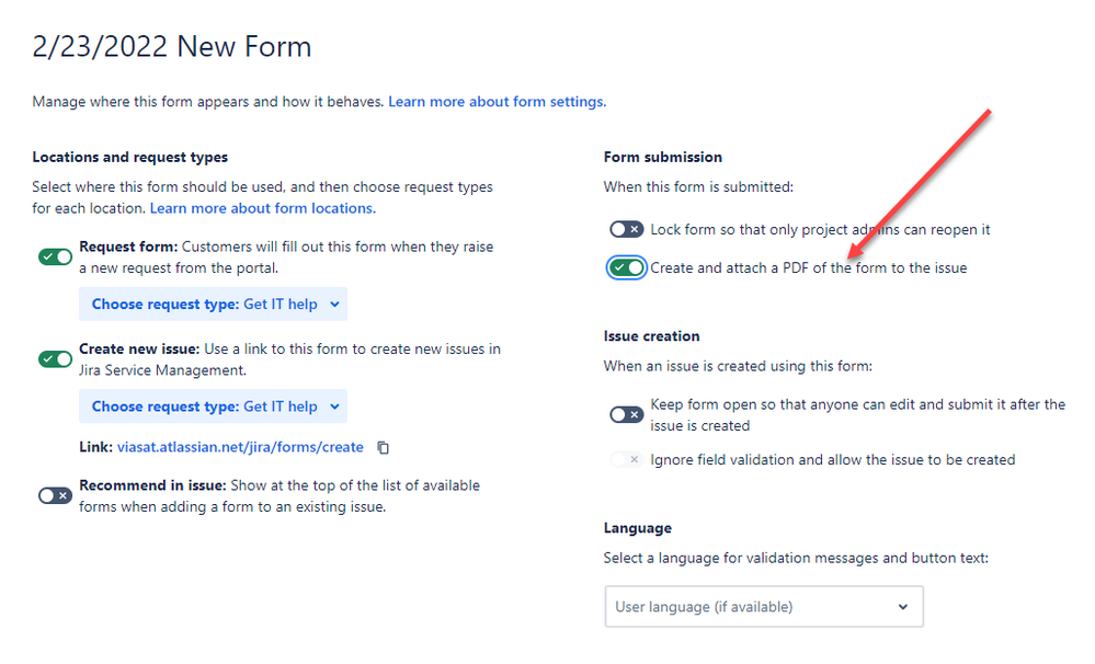

It is my understanding when one uses FORM design for issue creation in JSM, the reporter field will always be automatically populated as the one who submitted the FORM and created the issue.
Have you also setup the FORM design for your process where not only the issue is created, but the FORM is also added as an attachment (pdf) to the issue itself?
Once you setup the designed mentioned above, you will see the FORM pdf attachment, where it will contain the reporter and time the issue was created. You can then share the PDF attachment to other users as needed.
See example of the PDF extraction of the reporter/time information below -

As I am using forms in a Jira Service Management all the fields above do not appear on the form unless you add them, and then items like reporter do not automatically fill in.
