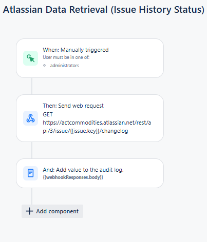

I am stumbling against an issue and have tried a couple of things and I hope the community can help me out.
I have a bunch of old tickets that have been closed, of which I need to retrieve data from, specifically the moment when the ticket went into the "In Progress" status. I already have a list of tickets for which I need this data from and I see that in the Issue history of the ticket, the timestamp of the status change is present.
I want to pull that data and place it in a custom field. Since its quite a number of tickets, doing it manually will take ages. From research I have seen that this can potentially be achieved via Automation and using API to pull that data. However, it is with the automation I am stuck at.
I have followed the instructions of the Atlassian Developers article on which API to reach in order to get the changelog data. However, everytime when I either validate the web request by using an example ticket or when I run the automation on said ticket, it returns with an error:
{"errorMessages":["Issue does not exist or you do not have permission to see it."],"errors":{}} | ||||||
The actor of the rule is "Automation for Jira" and it should have access to the tickets, but I still get this error. | ||||||

Dear Joseph,
Unfortunately my scripting skills are very basic. I'm doing as much as possible within Jira itself.
Yes, I have also ensured that these issues are not archived. I also contacted Atlassian Support, but they have not come up with a solution yet. Interestingly enough they also advised on posting the question on the forum. So here we are.
