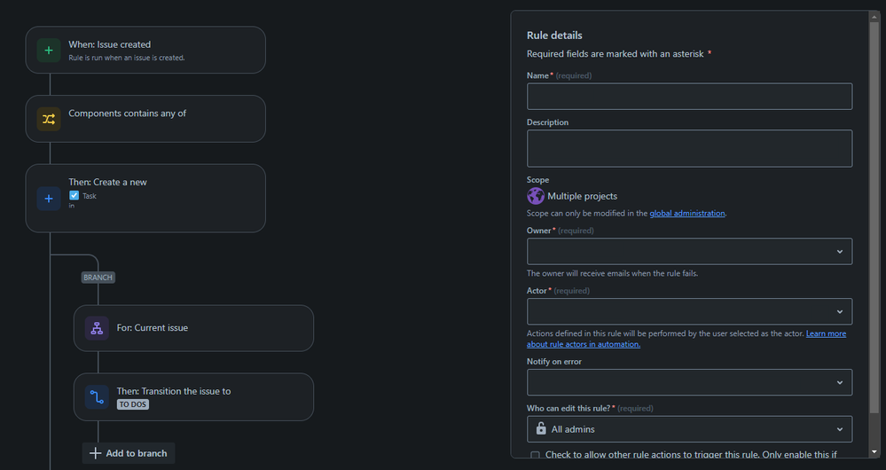

I've been trying to create an Automation that creates subtasks for a specific Process in our company. But whenever I run it I get this error code which translates to ,,The parent process does not belong to the corresponding hierarchy".
Hi Scherdin,
Can you share your rule that you have here? That will help us to better check it.
Go to Settings > Issues > Issue Type Hierarchy
But I don't think you will find set up will support what you are trying to do. You are trying to make a service-request issue the parent of a task issue.
You probably should not populate the Parent field on the create - get rid of that field.
Then after your create action, add an action to Link Issues.
