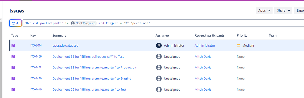

I've created a few more tickets in my test system, because I am curious to understand.
So, the statement != Request Participants, appears to work for both = Projects and != Projects.
Just confirming the consistency of numbers.

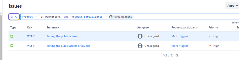

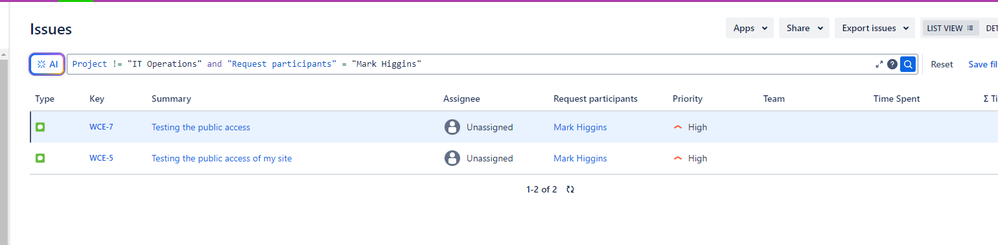

I tried putting my name in quotes, and it happily returned the results I expected:
So its consistent using my name or Atlassian ID.

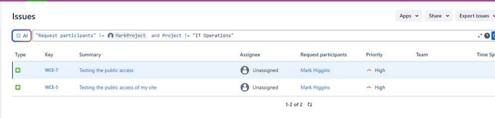

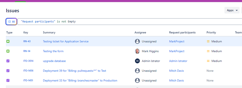

So I started with a straight query of 'Request participants" is not EMPTY

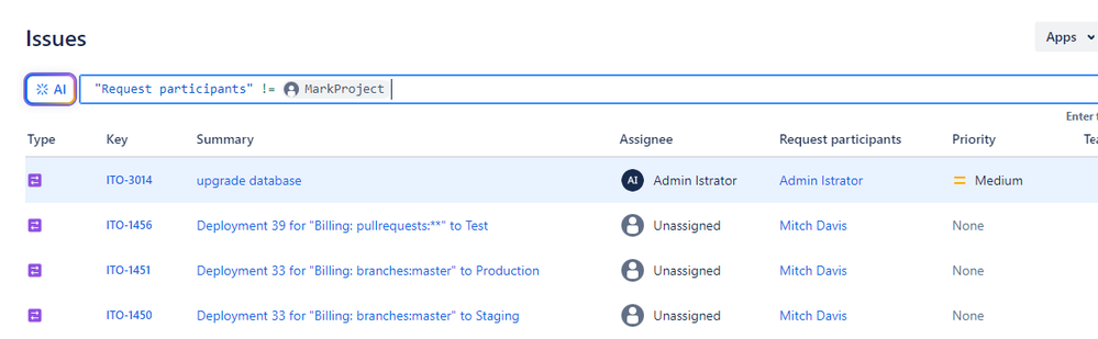

Then I changed it , so that it does not grab MarkProject.
Which worked as expected?
