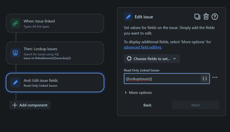

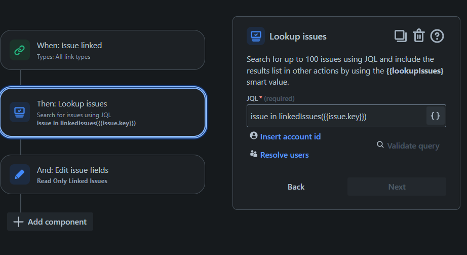

The best way I can think of to do this is to write an automation that triggers whenever and issue link is added or deleted. The automation should then use the "Lookup Issues" action to look up all linked issues, and then write them to a read only custom field. The automation will look like this:
Note: You will need to create two automations, one that triggers when a link is added and one that triggers when a link is deleted. You may also need to update your the rule details to allow other automations to trigger it if you have automations that create links.
Let me know if this works for you!
