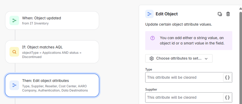

Second, there is an automation rule where you can delete all the inbound and outbound relationships automatically for one Asset object.
This works pretty well, however there is a big catch, you cannot have any mandatory in- or outbound attributes otherwise the automation rule fails. This is also far from ideal, since they are mandatory for a reason and just to remove this condition for archiving is a stretch.

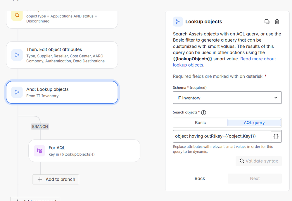

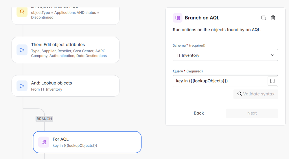

If you are still interested this is the relevant printscreens and AQL:
object having outR(key={{object.Key}})
key in ({{lookupObjects}})

You can simply create an automation like:
1. Trigger - Object Updated
2. If the Status have changed to "Deprecated"
3. Edit Object and remove all the values from it.

You can do Lookup object on the CF in your work-item.
Then  do Branch on AQL and set the scheme of the inboud/outbound.
Then, to a compare between the value in the CF.Outbound or Inbound and remove it.
