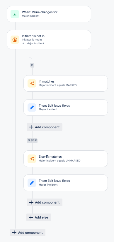

Just to follow up on where we landed in case anyone else has the same issue.
I offered several solutions to the team including the one suggested by Lisa F. above, and in the end, the MIM team decided they would prefer one of the other options wherein when the MI switch is toggled, an automation rule checks who initiated the action. If that user is not part of the Major Incident managers group, then it the switch is toggled back to the previous state. So, if turned ON, it will revert to OFF and vice versa.
Obviously, the caveat to this is that is if there are notifications or other automations triggered when the switch is toggled, it will not stop these from happening, only revert the switch back to whatever it was before. Imperfect solution, but it fits for their use case.
