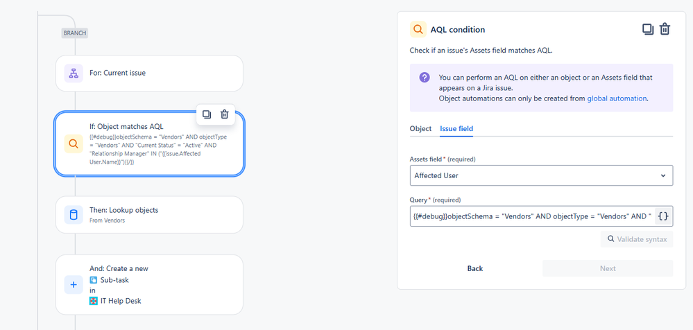

Here is a sample of the rule:
{{#debug}}objectType = "Vendors" AND "Current Status" IN "Active" AND "Relationship Manager" IN "{{issue.Affected User.Name}}"{{/}}
I am getting an "Assets field condition failed" error in the AQL Condition. I am not sure what I am doing wrong and have tried many different AQL queries. Any insight or recommendations pointing me in the right direction would be greatly appreciated.

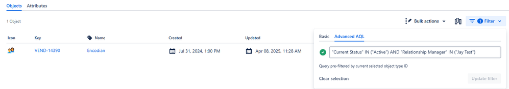

I try the Advanced AQL editor in Assets with and with out the parentheses and still would produce the results I expect, but for some reason is not working in the automation rule.

From the audit log screenshot I posted before, the branch rule was fully expanded so I can't see the keys. The branch trigger is set for the current issue, which is where the Affected User field is set. It looks like the condition did not find the match, but it should find VEND-14390.
Some information I left out was that each object type is in a different schema. Affected User is in the Accounts Schema (Employee_Data Object Type), while the Vendor Object Type is in the Vendor Schema. I thought defining the object schema in the AQL condition would help but that also didn't work.image.pngimage.png
I do have another branch in the automation that uses the same Affected User field to look up attributes in the Accounts schema. That is working. The problem seems to be when trying to query in a different schema.
