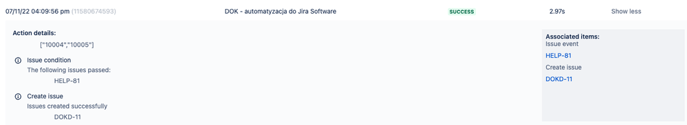

Second problem contains rule can't link issues without returns log information why can't. Even if the rule is executed correctly.

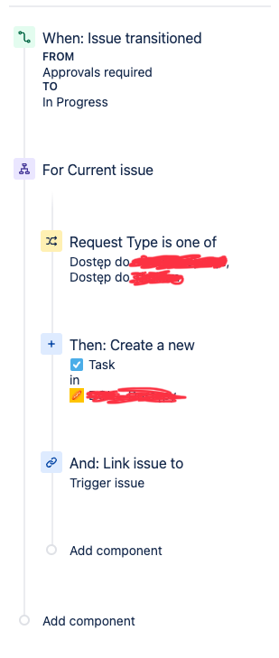

Screenshot with rule details is below:

Welcome to the community.  In your Link issue to action, you should use "Most recently created issue" instead of trigger issue.
In regards to the custom field error, just because the fields have global context, you will still need to ensure that those fields are part of your project's field configuration scheme.

You will need to verify your target project's field configuration scheme + target project's screen configuration scheme.
One thing you can check is manually create an issue in your target project to see if those custom fields are there in the issue creation screen or not.
One last thing, you also need to ensure that the rule actor has the necessary right against your target project too.
Best, Joseph
Adrian Bogacz November 8, 2022
Thanks for your help. The field configuration on the screen was missing. Linked issues also work after the change in automation.
