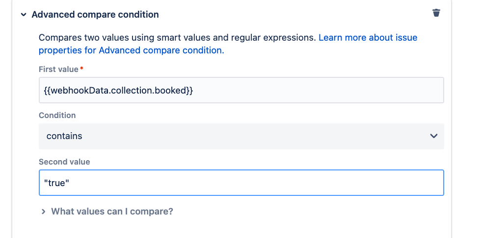

I'm looking to implement conditional logic for a jira automation triggered by a web hook based on the datat specified in the payload.
For example, with this json body being recived:

Hey, the issue I'm having with the advanced compare is that the second value after equals needs to be reresented as a string value, and doesn't seem to be getting recognised because of this:
Tried with and without the quotations. is there a better way to represent the value "true"? Possibly using another smart value/ regex value?
I have a work around to add the values form the webhook data to a text field and then base the condition off the contenbts of the field, but I think this way would still be much cleaner if possible.
Let me know, thanks!
Also I tried with contains to see if tht would pick up the text, also tried with capatalisd and lower case string.
What happens if you use this as your first value?
{{webResponse.body.booked}}
I typically breakdown my responses from the Send Web Request action with webResponse.body.xxxx and it works flawlessly.

No dice with that I'm afraid, to clarify this is for an incoming webrequest so I'm not sure it would be able to access teh response as part of the automation? More needing to analyse the data from the incoming hook.
Do the values true and false need to be represented as string values withing the advanced compare block as they are presented as strings within the data payload?

Ahh - I'm understanding now. I thought you were using the send web request action to get the data. I didn't realize this was using the native webhook functionality. I don't think automation will be able to link to the native webhook action, so I think your workaround is the only way to go on this one.
Am I correct to assume that you're using the native webhook instead of the send web request action because you want near real-time updates and/or dealing with a large data set? I ask because if this is not the case, it may make sense to try the API call with the send web request action instead.

Yeah i'm using the native incoming web request to receive ad-hoc updates from one of our suppliers (who won't be able to access the api directly).
