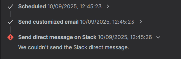

I have a problem with Jira Global Automation (Service management), whenever i try to do a rule, that sends the direct message to a person on a slack, it cannot be done.
I've synchronized both platforms, via Chat and video tools, or Slack integration itself. Everything else is running. Rule works, validates and it sends emails, but it cannot send DM on slack.
On slack: Jira Cloud, Jira, Jira ChatOps and Assist apps are implemented, it works pretty well. The permissions are also assigned, to write, to map the users between platforms, to see all the users at slack, to create a new DM.
Every synch setting is turned on and linked with the Slack Workspace.

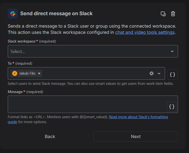

When you are sending the DM, are you using the user's Slack Member Id?
I probably can't use the member ID in this form, so I'm using email addresses, which are the same in both Jira and Slack. Then it shows me as in the picture below. Maybe I'm doing something wrong, or I'm using wrong form 🥲
I just tested and it looks like the new Send direct message on Slack isn't working correctly. I would suggest that you contact Atlassian support and have them look into it.
My test automation was able to send a message using the Send Slack message component, and if you use that one you can send DMs as long as you know the user's Slack member Id.

It look's like the initiation process of sending DM isn't working correctly, because automation rule works itself.

The particular action in automation sends a direct Slack message to selected users when an incident occurs. This is useful for notifying responders or decision-makers privately about high-priority events.
You can customise both the message content and recipients using smart values. To tag people in the message, use the format @{{smart_value}}.
This action will run successfully only for Jira Service Management incidents.
Source: Send direct message on Slack
Since we are using it for Scheduled events, the action is not working. For generic triggers, we recommend using the action: Send Slack message.
