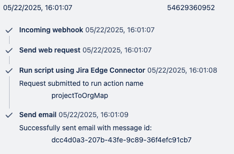

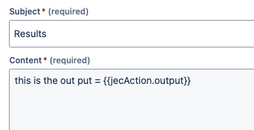

I've tried to access the smart values returned but it seems they have no value. As a test I tried to send the returned value to myself in an email (seemed easiest) but it has nothing (attached some images)
Screenshot 2025-05-22 at 16.21.23.pngScreenshot 2025-05-22 at 16.22.12.pngScreenshot 2025-05-22 at 16.06.12.png
I think it might be as you say that these features are reserved for enterprise licenced customers
