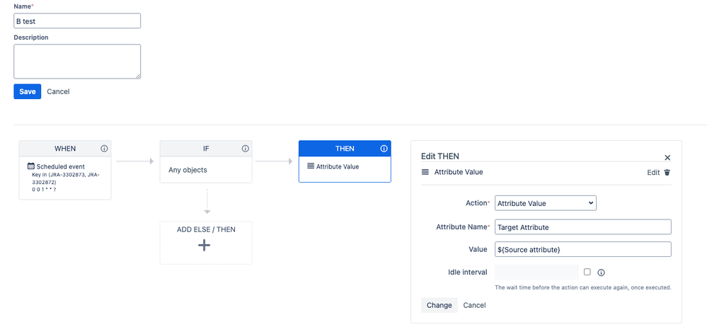

You can use the "old" Asset automations to do this. In the object schema configurations, add an automation rule triggered on scheduled event. Then setup the action "Update Attribute value" to copy the attribute value. Use asset placeholders to get source attribute value ${source attribute} to update the target attribute

Placeholders, of course!
I'm still learning my way around Assets, and finding answers searching the internet requires that the correct question be asked. I had forgotten the term "placeholders".
This was exactly what I needed @Björn Gullander Eficode . Thank you!
