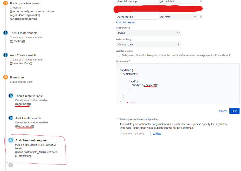

I have an automation in which I want to conditionally set smart variables through if-else blocks and use the resulting variables in a POST web request hook,
When I try to have a single web hook in the very end of the automation, after the if-else blocks, nothing happens. Contrary, if I add the POST request to every if-else clause, it works as expected, however a lot of redundancy and tedious to maintain,
I want to have a single web request like the above, in the very end.
BONUS: If you have a way to shorten it by setting the smart variables, conditionally, without neither if-else blocks nor looktup tables, I would appreciate that as well :)

Frederik Strøm Friborg January 10, 2025
Hi @Marc - Devoteam
Thank you very much!
Sorry, I realise the image does not capture enough context; I have multiple else-if statements underneath the if statement that do not show on the image...
Every if/else-if/else clause matches a status and sets smart variables comment and transitionId based on the matched status and adds those to the web request, as in the image,
The problem is that I have to add the web request inside every single if/else-if/else statement for it to work, instead of having it run after the IF/ELSEs, just once, like so:
if (status == 1):
    comment = some comment
    transitionId = some id
else if (status == 2):
    comment = other comment
    transitionId = other id
webRequest.execute(comment, transitionId)
