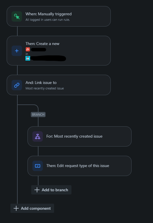

Exactly what I needed.  Looks like the "Create Issue with request type" didn't like all the custom fields we were passing, but the branch "most recently created issue" worked fine.  For anyone finding this in the future: make sure the scope includes both service boards and here's the rule layout (the link issue just links the created issue to the original):
