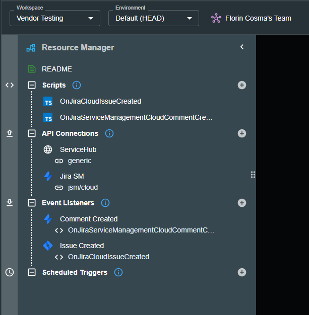

Connectors:
And this is the workspace:
I am still getting the hang of it, I don't have much scripting knowledge. And now I am trying to figure out how to send and receive the required information.
