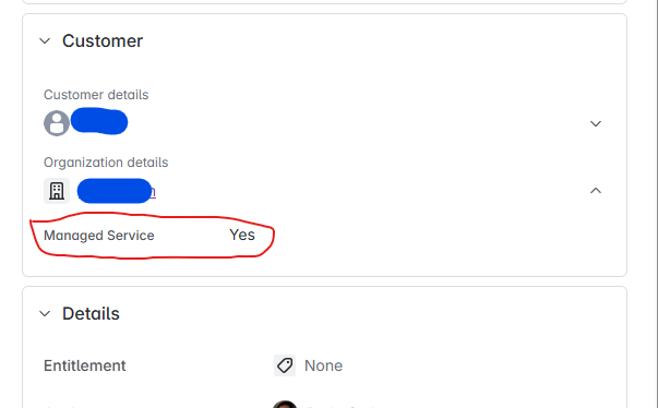

Rudy Setiawan August 13, 2025
Is there a way that we can automate whenever a new work item is created, it will check against a value in the custom field within the Organization, then label the work item. Thank you

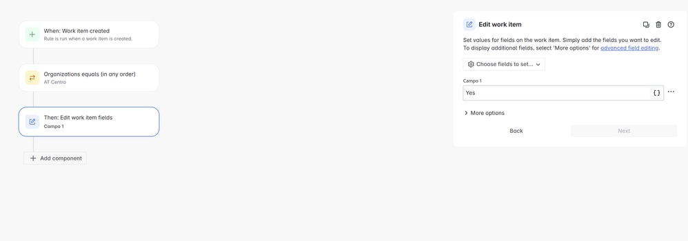

Hello @Rudy Setiawan ,
You can use this automation structure:
If you have any questions about the automation, please let me know. The explanation is as follows: when a workitem is created and the organization is “AT Centro” (for example), you set the value “Yes” in Custom Field 1, also you can edit  labels fields.
Regards
