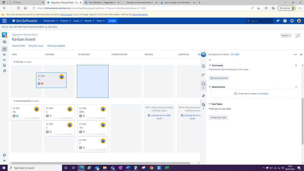

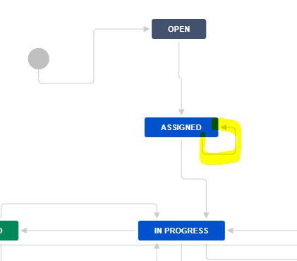

In the image below, I have shown part of my current workflow. I have created a transition from "Assigned" to "Assigned", and created a transition screen for that. However, when I try to move a ticket on the Board from Assigned, the only option available is "In Progress". When I drop the ticket back in "Assigned", the transition screen I created does not show up.
To answer your 1st question, there is no work around since WF is now driving the control.
In regards to your second question, I believe your WF setup + board column setup may be mis-configured. Can you provide your WF status mappings to your board columns + your transition condition configuration?

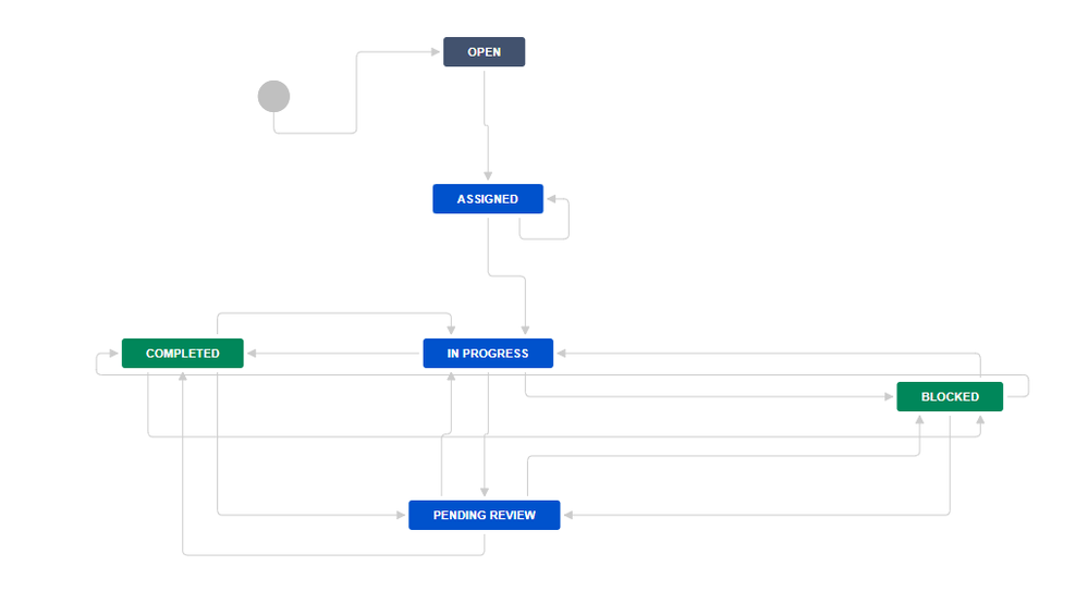

@Joseph Chung Yin Thanks for offering to help and apologies for the delay.
Attached are three images
1. WF statuses
2. 'Board Column Management' to show WF status mappings to my board columns
3. Transition condition configuration - I've shared the configuration for the transition that goes from "assigned" to "assigned" (one condition that only 1 user group can move tickets)
Be very good to get your thoughts on how users can change the priority/assignee without making a transition, if those questions only exist on a transition screen.
From the board, you will not be able to triggered "Assigned" to "Assigned" itself transition. However, you can access the issue directly and from the issue view UI, you will be able to conduct the transition. Your condition setup is correct.
