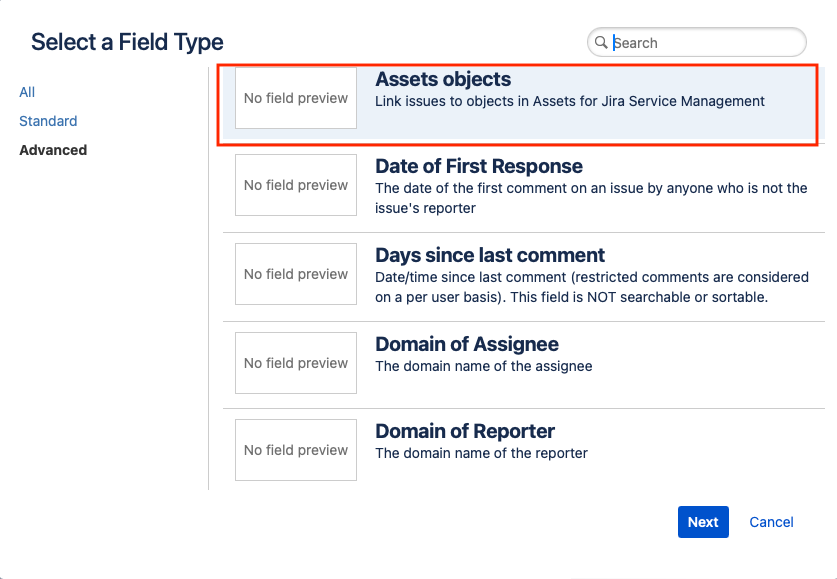

When you create your custom field based on (JSM) Assets objects, make sure you choose Assets objects and not External Asset platform.Screenshot 2023-09-28 at 11.40.46 AM.png.

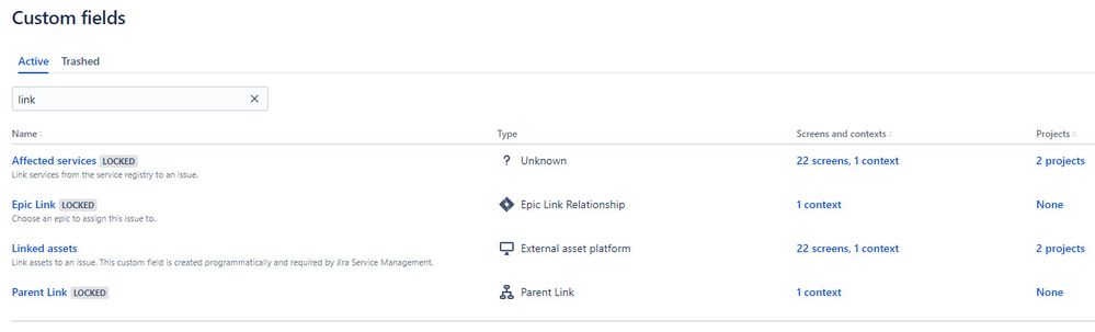

I found where the custom fields are but it doesn't look like there's a way to change it.  As a trial user who hasn't customized anything, this isn't going well.  Why are built in fields called custom fields and why isn't it working out of the box?  I suspect the third party external app caused the issue but that was uninstalled.  Thanks2023-09-28_15-20-35.jpg
RobertD September 28, 2023
I was able to create a new field based off your screenshot and have it working now.  Still the question remains, why was the out of box field with the description "Link assets to an issue. This custom field is created programmatically and required by Jira Service Management." not working?  Is it safe to move that to trash?

At this point, it's better for you to create the custom field you want (using the field type I identified).

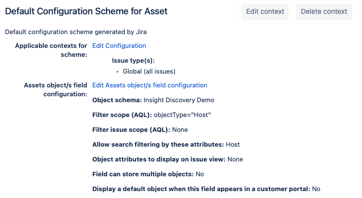

From the resulting screen, you'll have to set up which  Assets objects are associated with the field.  Click Edit Context and at least fill out Object Schema and set an Assets Query Language (AQL) query for Filter Scope (AQL):
