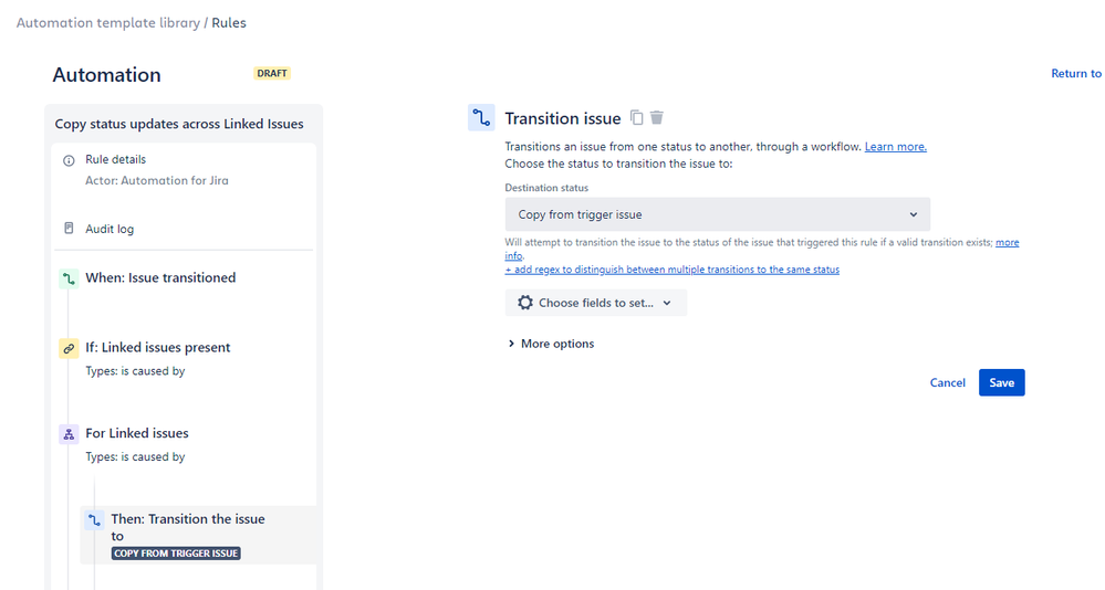

You could experiment with this rule from the automation library and tweak it to your needs, similar to the below one:
Feel free to change the link type and/or add conditions before executing the transitions.

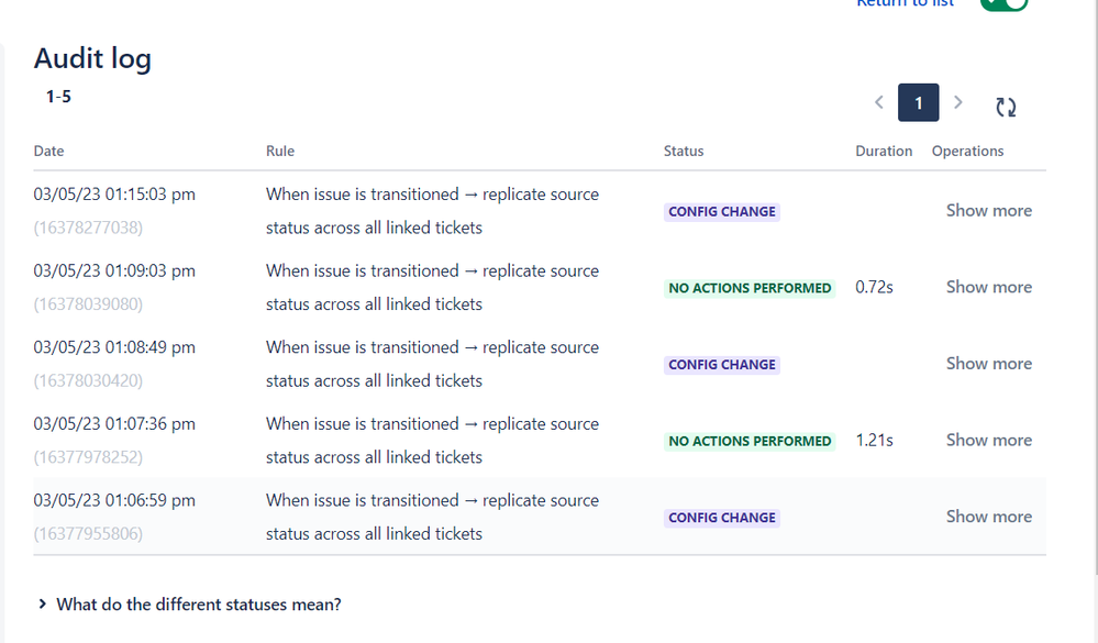

I built the following but it isn't working and not even reporting an error. I also tried switching the "duplicates" to the "is duplicated by" place thinking that could be it, but nothing changed.
Little I can do without having more info. What does the audit log say?
