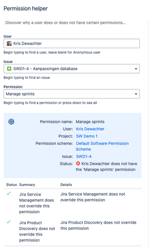

All 3 projects use the same permission scheme. I checked with the "permission helper" and this confirms i DO NOT have "Manage Sprint" permissions, on any of the 3 projects.
