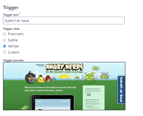

Is this regarding issue collectors? You can go to project settings > issue collector > edit
then under Trigger style they will move the widget to different areas I believe, or you can use custom and see if you can set the location and style to your needs

Hi Jason, Unfortunately I'm not super familiar with the collector beyond the basic configuration. I think if it's all using the issue collector the style should apply regardless of issue type
