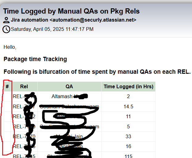

I have written table within my Send email component.. My Table renders absolutely fine. Now, I am trying to add Incremented Serial numbers to each row of my table. But I am not able to do that
Solution tried
Added a variable
Added it in my send email body as
But my Email shows the # field blank

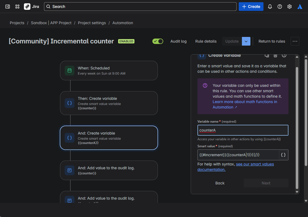

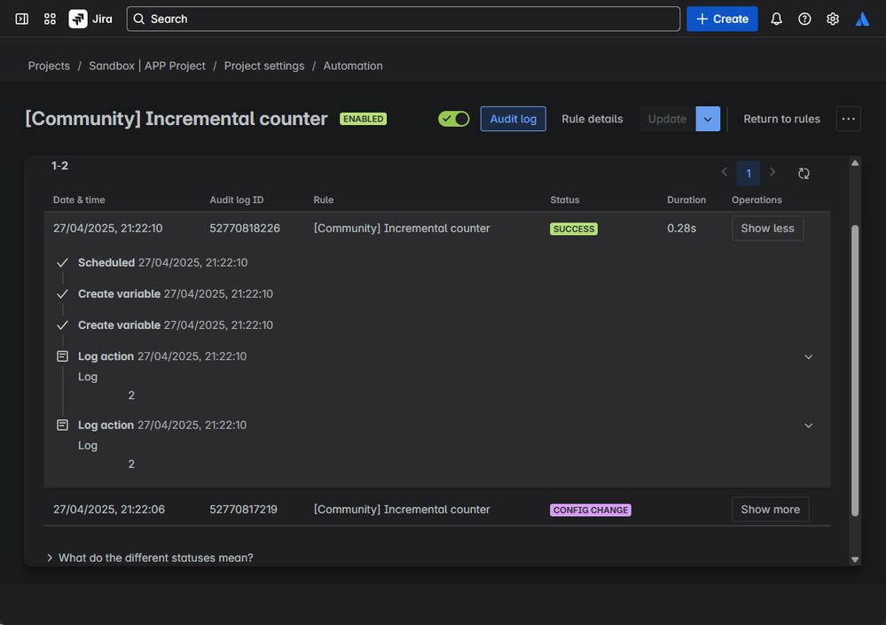

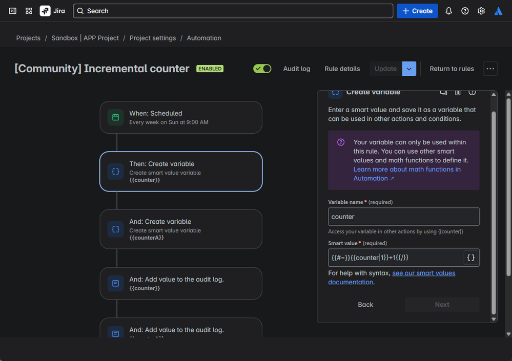

I tried with all the following combinations
  • {{#=}} {{counter|1}}+1{{/}}
  • {{#increment}} {{counter|1}}{{/}}
  • {{#=}} {{counter.asNumber|1}}+1{{/}}
  • {{#increment}} {{counter.asNumber|1}}{{/}}
  • {{#increment}} {{counter.value.asNumber|1}}{{/}}
  • {{#=}} {{counter.value.asNumber|1}}+1{{/}}
but unfortunately, my output is still the same.
