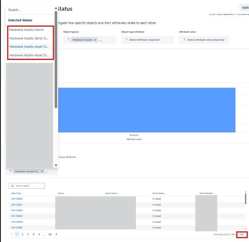

2. Number of object shown are reduced drastically if there is more attribute selected. Below is when I have selected to show more 2 more attributes ( "Asset Owner" and "Serial number" ). The number of object shown are now dropping from 2,398 before to 1,283 objects. I will get 1,722 objects if I removed "Name" after that.
In this case the report cannot be used as it does not show objects or insufficient detail. I believed this is limit to the size of fetching allow. Is there any work around?
