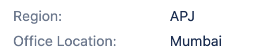

Just to clarify on your current field for "Office Location", I believe this looks to be set up as a text field?
In which case you may be fairly limited using that particular "issue fields condition" as I believe it may require/expect a value and not multiple values.

Thanks for your Quick response. PFA screenshot .
My requirement is :
we have 3 region AMR / EMEA /APJ and different location. (in each region)
Here i need to set automation rule Region & Location - assign to agent accordingly
Pls share possible steps thanks

To give you an example of what I mean, in terms of using "single select fields" instead of "text fields" - you can see here, makes it a bit easier to select and/or read either way:
So this means I can pre-populate the Office location with a list of known locations, then select one of more of these in the automation - the same can be applied for Region should you need it, but if there's only "one" region to select, change the Is one of, to equals.
