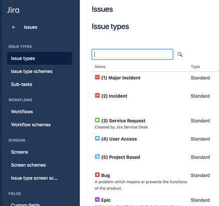

To simplify it and provide a solution to you, you can rename your issue types to start with a number, like this:
It will do the trick and not add any complexity to your project and users.
