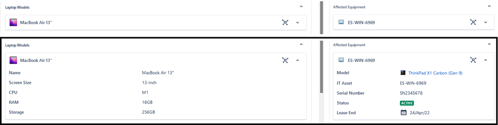

Below is my end goal:
However... Currently the Affect Equipment field (on the right) can't autopopulate itself. I've narrowed it down to a manual dropdown which only shows Insight objects of the type Laptop which is assigned to the Reporter.

Edit: Mikael's response below worked! Amazing!
Yes, you can get it done by using automation, this is what my automation looks like that sets the link asset field:
