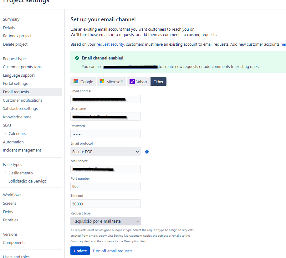

Could you please confirm the below one is not used (as in configured additionally by mistake) and only the first mentioned on the top is in use?
Could you probably share an anonymized screenshot of those parts of the configuration?

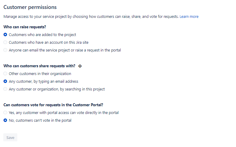

Here it goes!

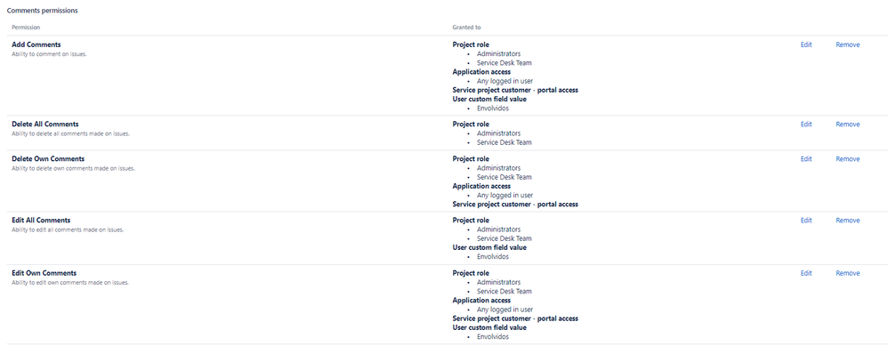

Jeff Santos
August 3, 2021
I REALLY don't know what is happening and don't know what to do either.
The permission seems ok:
Jeff Santos
August 4, 2021
I realized that all my screenshots  turned into the same.
Here are te other one showing the error to the same same the permission indicated ok:
