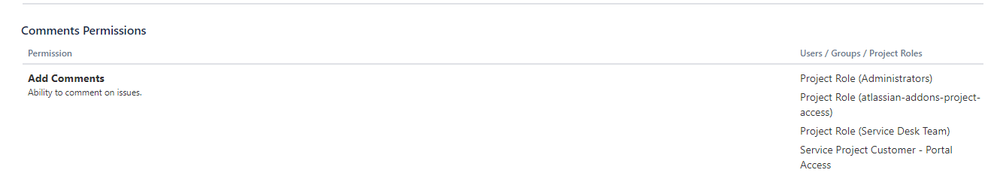

In the permission scheme for the project I enabled the user to add comments as shown in your screenshot.
As soon as I take away the user from "Serviceprojekt-Agent", he can no longer add comments to the customer, only internal ones even though "add comments" is still enabled for the user.

You can remove the group Serviceprojekt-Agent from the possible groups that can add a comment and replace it with whatever group you want, as long as the members of that group hold a JSM license, they would be able to write the comment.
  • Create a group for the Vendors.
  • Remove the Serviceprojekt-Agent from the Add Comments permission.
  • Add the newly created group for the Vendors in the Add Comments permission.
Please note that the vendors would be members in both groups, but only the new group would be able to add a comment.
    >>> I added the group under "Add comments"
The user cannot add comments that are visible in the customer portal, only internal ones.

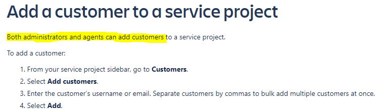

After reviewing,  if the vendors users hold a license, they would be able to invite customers.
https://support.atlassian.com/jira-service-management-cloud/docs/add-a-customer-to-a-service-project/
And in order to make a public comment, they need to be an agent,  so there is no way of allowing them to make a public comment but not being able to add customers.
