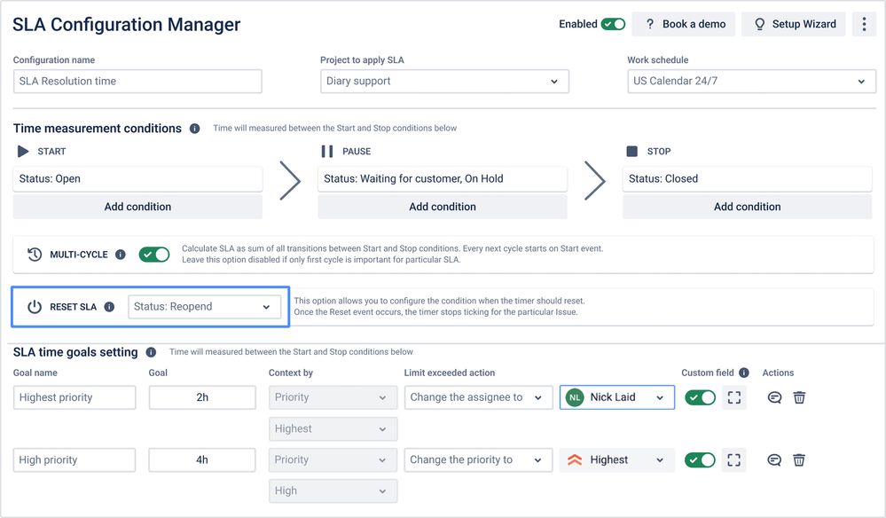

If you’ve configured your SLA (Time to Resolution) after tickets were already created or closed, Jira doesn't retroactively apply SLAs to past issues, which is why you’re not seeing SLA data on those tickets.
To solve this, I recommend trying SLA Time and Report, an app developed by my team. It allows you to recalculate SLA values even for closed tickets.
With this app, you can:
✅ Use the “Reset SLA” feature to apply SLA logic to older issues
✅ Configure SLA goals and conditions + run recalculation
✅ Include resolved/closed issues in your SLA reports
✅ Track and analyze SLA compliance across your full ticket history
Let me know if you'd like help setting it up. I'd be happy to assist! 😊

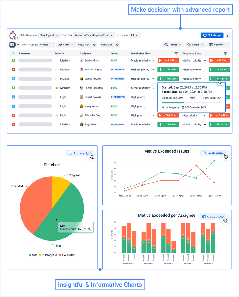

I tried using this app and configured the SLA and the condition.
However for the month of June there is at least 100 JIRA tickets but the dashboard is showing 10 tickets and they are all subtasks.
There's been some configurations to get JIRA running . I've gotten rid of subtasks on tickets now.
So I don't understand how to get rid of sub tasks?
If i used the default filter function I'm getting all the tickets but using the app I'm getting 8 sub tasks and not tickets?
I tested this app after configuring the SLA and conditions. However, for June, there are at least 100 JIRA tickets, but the dashboard only displays 8—all of which are subtasks.
Some initial setup was done to get JIRA working, and I’ve since disabled subtasks on tickets. Despite this, I’m unsure how to completely exclude subtasks from the results
When I use the default filter, I see all the tickets correctly. But with this app, it only shows 8 subtasks instead of the main tickets.
Here are two different views
The SLA time and Report is showing 8 sub tasks for the month of June while the built in filter for JIRA is showing all the tickets for June
Hi @Ronald Lam , thanks for the updates and for testing things so thoroughly!
From what you’ve described, it sounds like the issue might be due to the ticket type selected during your SLA setup. It’s possible that the SLA configuration is currently targeting sub-tasks only, that’s why you’re only seeing them in the dashboard instead of the main issues.
To help troubleshoot this properly, could you please share a screenshot of your SLA configuration? This will allow me to pass the details to our team and help identify what’s filtering out the main tickets.
Once we see that, we can guide you on how to adjust the setup to ensure only parent tasks are shown in the report.
Appreciate your patience. We’re happy to help get this sorted!
