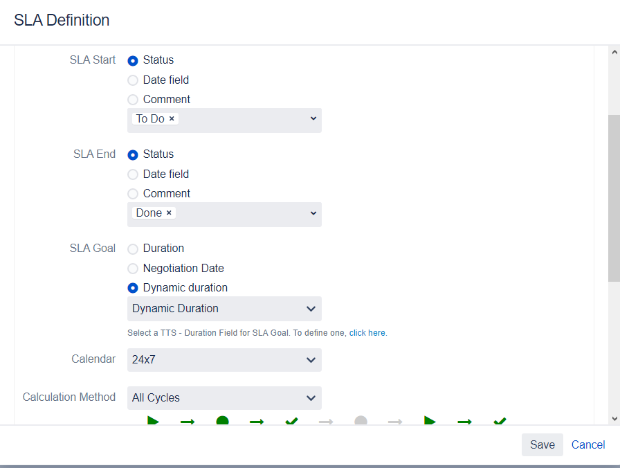

I don't think JSD SLA offers such a feature. However Time to SLA does offer such a feature with the help of a custom script. TTS has the "dynamic duration" feature that allows users to set SLA Goals on the issue-level and for your use case you can set this field with a script dynamically to reflect the remaining SLA Goal for the month after the "used" SLA working durations are subtracted. You can check out the documentation.
I'm from Snapbytes and we can help you with the script as well. Let me know if you're interested or you can open a support ticket through the customer portal

Thanks for referring it, but it looks buggy adon. When i am trying to create the SLA and selecting the dynamic duration for SLA goal, its asking to select the custom field. Its already there but not able to select any field.

You need to create a TTS dynamic duration field through Time to SLA top menu > SLA fields> Add custom field > TTS duration field. After this, you can select dynamic duration field.
Fora more detailed explanation you can refer to our documentation

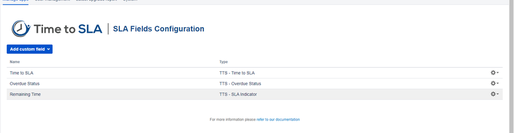

Gökçe Gürsel {Appfire}
June 25, 2020
The custom field needs to be "TTS-Duration field" type. Could you select Add custom field and then TTS-Duration field?

Thanks , yes i can see the field now. let me eveluate it

Thanks its good plugin but not fulfilling my needs.  My requirements are first ticket is created and if its consumed 5 minutes, For next ticket remaining SLA should be target - last spent time on previous ticket. I tried the dynamic value but its generating same value for every new ticket.
